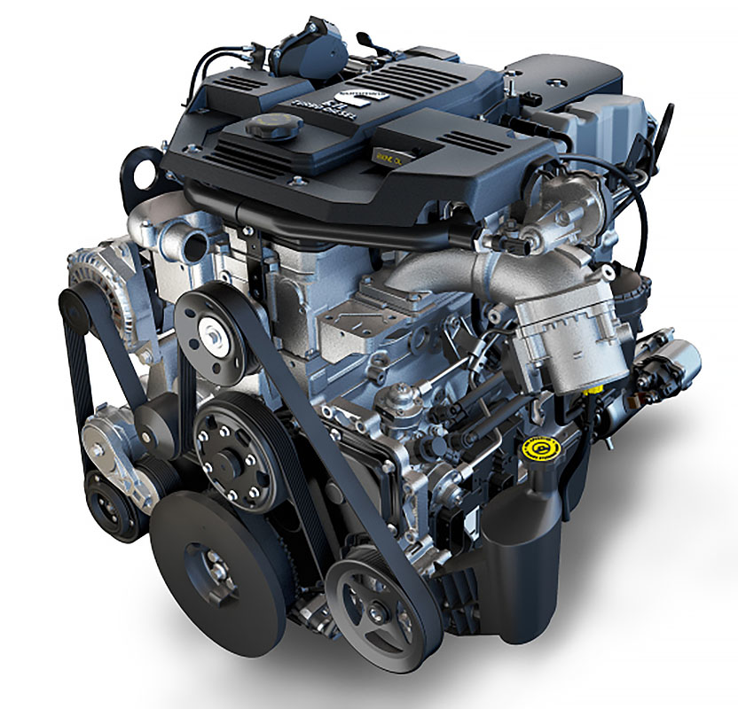

6.7-liter in-line turbodiesel engine for the Ram Super Duty pick-up

Compacted graphite iron continues to make an impression in consumer markets thanks to diesel engine programs: the Ford Motor Co. 3.0-liter V6 turbodiesel engine for the F-150 pick-up earned a Wards’ 10 Best Engines award at this month’s North American International Auto Show (NAIAS), and a new, 6.7-liter in-line diesel engine was introduced there for the Ram Trucks’ Super Duty pick-up. Both engines are based on a CGI block produced using SinterCast process control technology.

The new, 400-hp 6.7-liter engine in the Fiat Chrysler Automobiles pick-up will be cast at the Tupy foundry in Saltillo, Mexico, starting in 2Q 2019.
“The start of production of the Ram 6.7-liter diesel marks the first application of CGI for in-line diesels in a passenger vehicle application, delivering high-volume series production in each of the ‘Five Waves’ that SinterCast first presented in 2002,” stated Dr. Steve Dawson, president and CEO of SinterCast.
“As a replacement program for an existing engine, we anticipate a vertical ramp, potentially providing production of approximately 300,000 'engine equivalents' (15,000 metric tons) per year, and providing significant contributions to our target for double-digit growth in 2019 and to our campaign to break the three million engine-equivalent milestone.”
