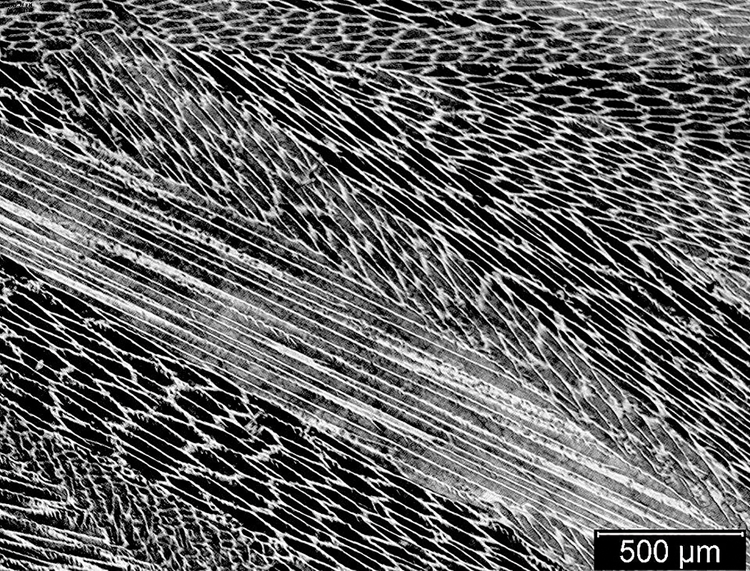

Cast CuMn Alloy micrograph

A separate line of research has played out at Purdue University, where a series of copper-manganese alloys have been found to provide greater strength and castability than the common non-lead alloy options for brass foundries, such as bismuth.
“Our alloys have been shown to have superior overall mechanical properties compared to other cast, lead-free alternatives,” stated Prof. Kevin Trumble, professor of materials engineering at Purdue and director of the Purdue Center for Metal Casting Research.
“We are helping to meet the growing need for new alloys with superior mechanical properties, especially amid an increasing amount of government regulation requiring industries to reduce the lead content they use,” Trumble added.
The Purdue researcher noted the new copper-manganese formulations “solidify over a very narrow temperature range and are completely free of microscopic shrinkage porosity, and have higher strength, so thinner-walled castings can be used compared to their counterparts.”
Trumble also said that, in addition to their metallurgical and mechanical advantages, copper-manganese alloys are more affordable than other lead-alternative materials.
He said the Purdue research team had proven the alloys’ effectiveness to be feasible, cost-effective alternatives for water pumps and marine-industrial components, and “now we are turning our attention to many other potential applications for our discovery.”
