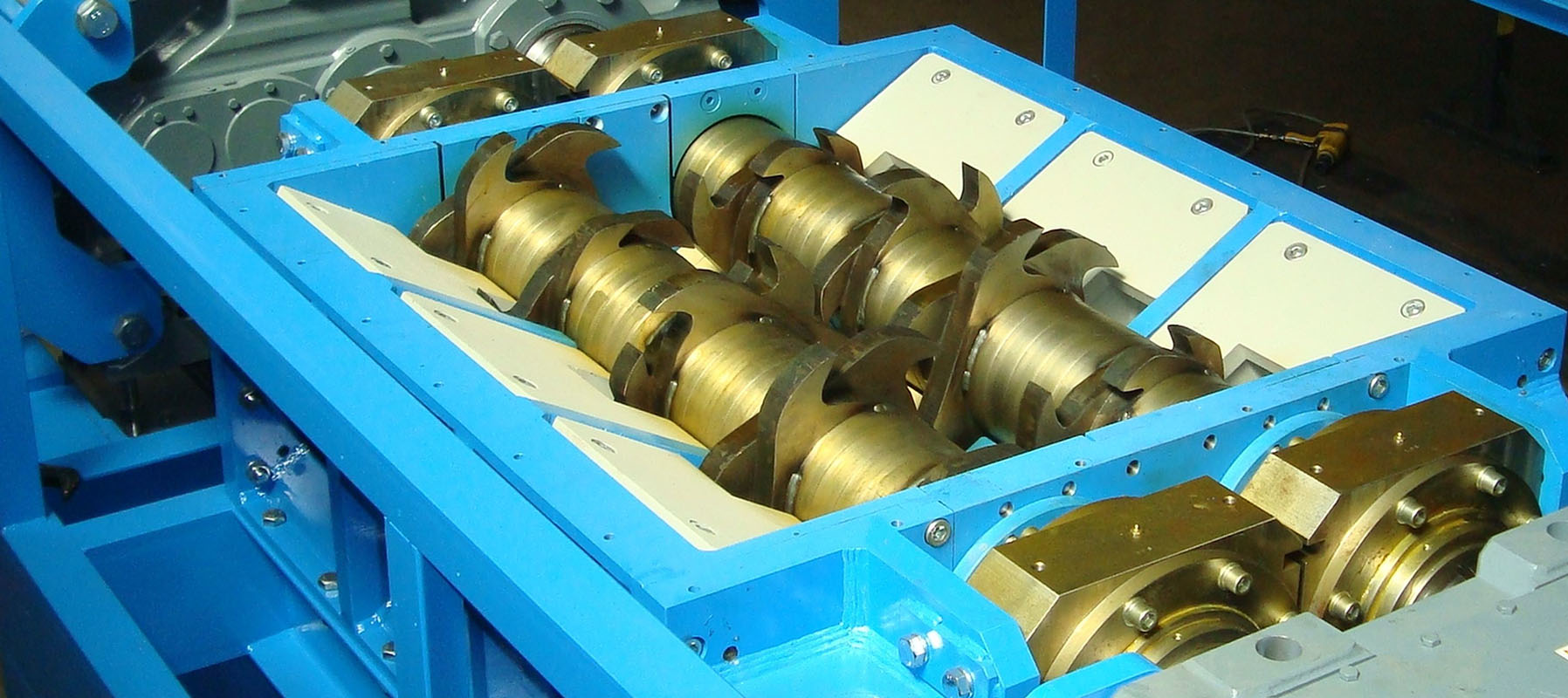

The M600 single-shaft shredder developed by Erdwich Zerkleinerungs-Systeme GmbH can be installed directly on the diecasting machine, offering an all-around remedy. It minimizes the space, logistics, and time required to handle zinc scrap and makes manual handling unnecessary.

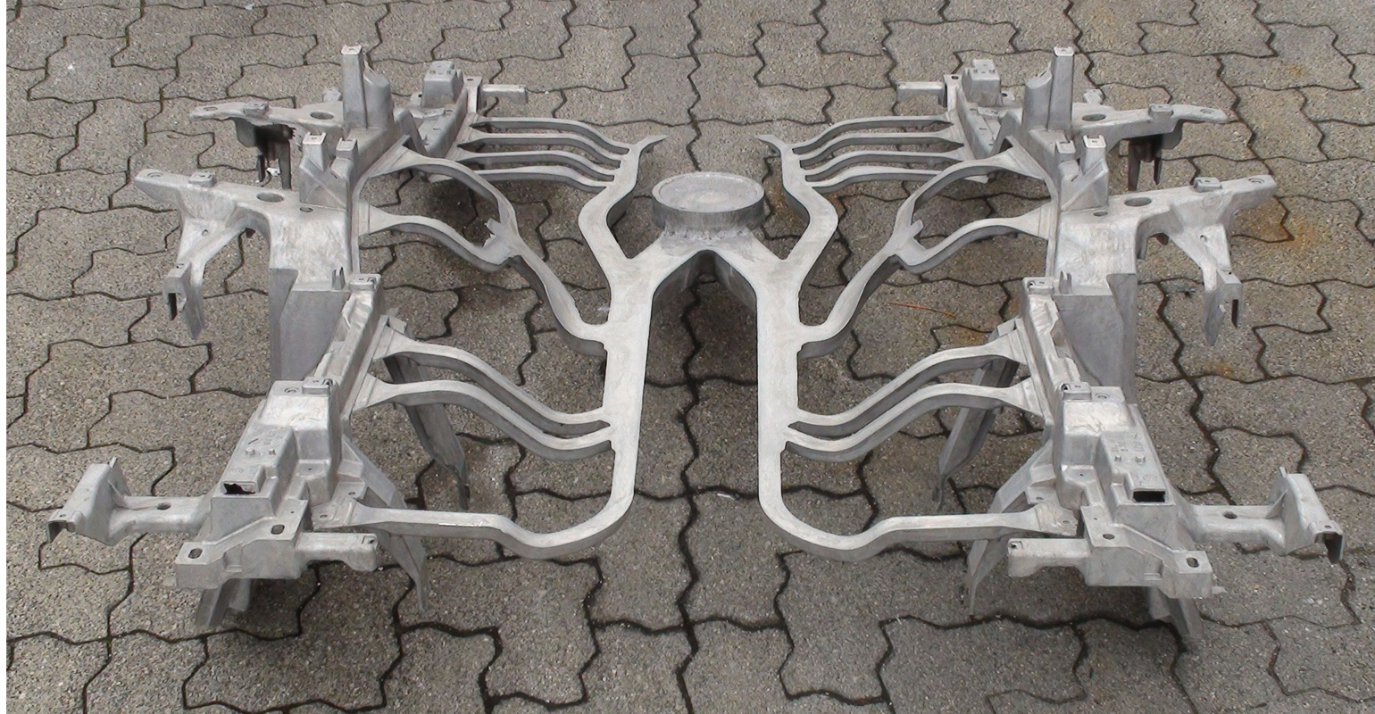

The long view – Zinc diecasting has been established as a mass production process for a long time: Depending on the size of the product to be manufactured, it is possible to produce hundreds of parts per hour with just a single diecasting mold. Particularly in the production of parts for automotive assembly or for mechanical engineering, sprue and runners, punch burrs, or defective workpieces can lead to full scrap containers within a very short time. If these are not replaced quickly enough by empty containers, this results in a considerable impediment to the operating processes – in the worst case, the production speed has to be throttled.

One of these models is the M600 single-shaft shredder, which is available with different cutting gear lengths. It was designed for shredding small diecast parts weighing up to 2 kg and can significantly reduce the volume of the parts by up to 60%. "With our plants, we always make sure that they fit the specific requirements of our customers," Erdwich explained. "That's why we offer the M600, as with most of our shredders, with different sizes of cutting gear and drive powers."
The compact machine dimensions are another advantage because, depending on model, the plant takes up just 1.5 m2 of floor space, so it’s possible to operate even in confined spaces. In addition, EZS designs emphasize long service life and ease of maintenance: The fully hardened knives, which can be reground several times, ensure the long, uninterrupted operation of the shredder.
Fully automated for integrated operation – "In addition to the M600, we also offer plants that are suitable for shredding larger scrap parts," Erdwich explained. "These include the M465 and M(H)480 twin-shaft shredders and the RM1350 ripper, which can efficiently shred and break down parts weighing up to 10 kg, or even complete body structure components.
