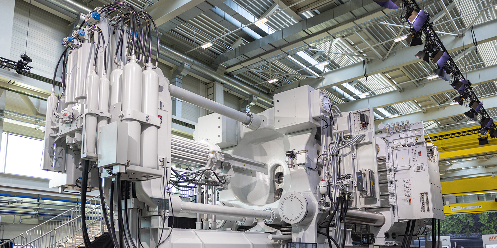

Bühler AG's160-square meter Carat 840 machine, capable of injecting more than 200 kg of molten aluminum into a die “within milliseconds' to form large-dimension castings for automotive structures.

In June, Bühler introduced its own new megacasting package, the 160-square meter Carat 840 machine, capable of injecting more than 200 kg of molten aluminum into a die “within milliseconds,” to form large-dimension castings for automotive structures. Rheocasting is seen as a supporting process technology. Bühler's Comptech announcement came a few weeks later, on August 15.
