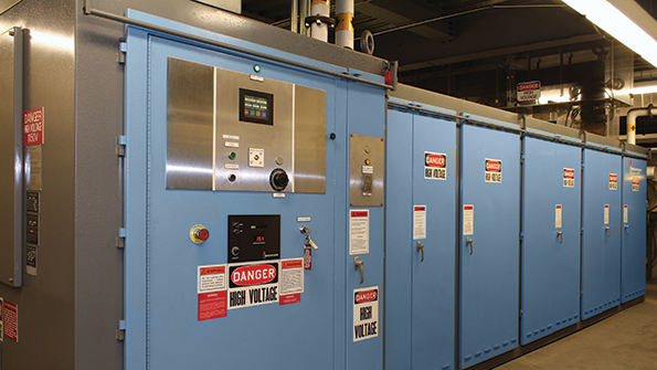

Induction melting operators must understand the fundamentals of electrical power quality, and how to achieve and maintain it. Causes and effects Standards and regulation The power factor
Like all raw materials and resources used in industrial processes — such as melting in a metalcasting operation — electricity needs to be managed and controlled in order to be useful and effective. “Harmonics”, i.e., the variety of voltages and currents that develop within an electric power system as a result of non-linear electric loads, can be a source of power-quality problems, and may result in increased heating in equipment and conductors, or failure in drives or motors.

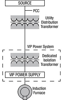

Total harmonic distortion (THD) is the ratio of the square root of the sum of the squares of the individual harmonics to the fundamental RMS value. THD is used to gauge utility line distortion. This standard and other international standards impose a limit on the total harmonic distortion of the voltage and current at the point of common coupling (PCC). The PCC is where the plant is connected to the utility line. Normally this will be the primary of the utility transformer feeding the plant, as shown in Figure 2.
