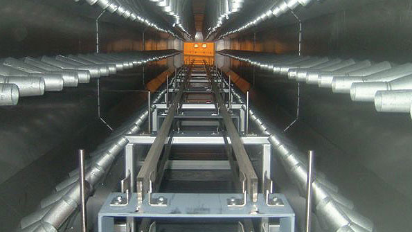

Conveyor for gear manufacturing —A Milwaukee plant needed to dry a zircon-based core wash on sand molds used to cast large gears. Each molds is 70x50x40 in. (WxLxH) and weighs 3,000 lb. They had to be dried at the rate of one every 5 minutes in order to maintain a production rate of 36,000 lb/hr. Conventional conveyor designs were not up to the task, relying on a flat wire belt conveyor riding on a friction style slide bed, which is simply a structural steel frame to support the moving conveyor belt. With the combination of mold weight and conveyor speed (1 ft/min.), a conventional design would wear out quickly due to the heavy load on the conveyor and the resulting friction between the belt and slide bed.
Wisconsin Oven developed a roller belt support system whereby the conveyor belt rides atop specially designed high temperature rollers. The rollers use a high-temp lubricant that reduces friction by a factor of eight, compared to a conventional, friction-style slide bed arrangement. In addition to significantly extending the life of the conveyor belt, this reduced design allowed the use of a smaller conveyor drive motor. The result is a long-lasting conveyor design that is also rugged and energy-efficient.
The oven has an operating temperature of 575°F (302° C), and a heated length of 21 ft. (6,400 mm), which required 42 support rollers on 6-in. centers.
