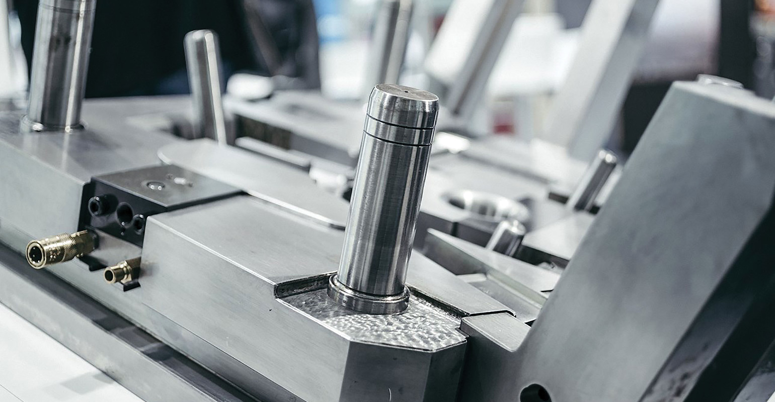

Tooling and materials. Molds must be designed in such a way that they can permanently withstand the loads related to the large melt quantities. When the metal has solidified, the mold halves open and the cast part is ejected by bolts or removed by a robot and conveyed for further processing.
Molds are critical to the process: They  determine the contours to be transferred to a part, and also should enable the metal to solidify as quickly as possible. This promotes formation of a fine-grained microstructure, which enhances casting quality.
Molds are designed to promote optimal cooling, which also may shorten production time (with obvious economic advantages.) The design of diecasting tools is described in the standard DIN 16760-1.
The tools used in the diecasting process are inevitably exposed to high thermal and mechanical loads and must be able to withstand them permanently. For example, molds for zinc diecasting reach service lives of 500,000 to 2 million cycles. In order to achieve such performances, the diecasting tools — which besides the molds include mold inserts, cores, slides and ejectors, are made of high- strength hot-work steels such as X40CrMoV5-1 (1.2344) or special materials, for example hard metals. Tools typically are designed to provide high wear-resistance, high ductility, high heat-resistance, high hot-tearing and hot-wear resistance, and good thermal conductivity. When choosing diecasting materials, their technological properties, the design of the tools, their heat treatment, and the complex interactions between the tools and the metal to be cast must be considered.
