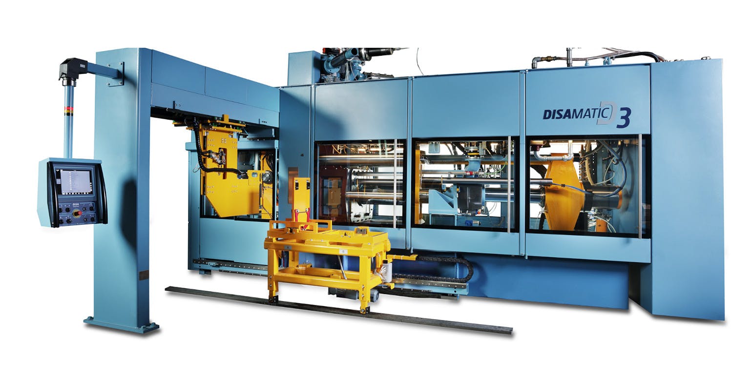

Currently working with steel castings, the testing foundry will focus on a different alloy every few months, with results to be updated regularly at DISA’s LinkedIn channel. According to DISA, its testing foundry already has proved the effectiveness of a DISAMATIC D3 vertical molding line for a U.S. producer of brass castings.
The DISAMATIC D3 is designed for high speeds, high yields and maximum uptime and performance, with high throughputs of up to 555 uncored or 485 cored molds per hour.
