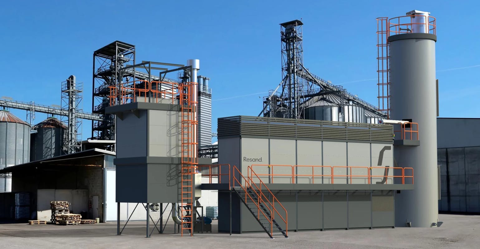

The two-stage process starts with a heat-treatment cycle to remove binder residues from molding sand, followed by a mechanical drum sequence that separates any other impurities. The company reports the process can clean 1,000 kg of sand per hour, material that provides 95% of the mold strength of virgin sand.
Resand describes the treatment unit as “a modular system that is quick and customer-friendly for the foundry to install and commission, with a delivery time of only 4–5 months.”
