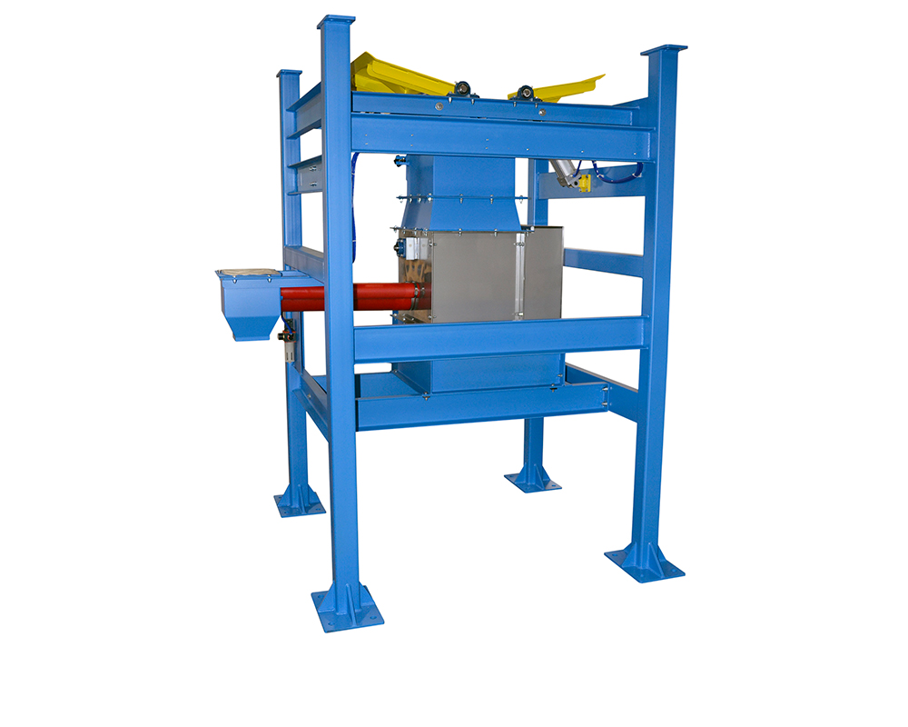

A dual-helix design combines fast, high-volume filling with accurate dribble flow at the end of the cycle.
BEST PROCESS SOLUTIONS designed the Model TSF twin-screw feeder for precise batching and weighing applications. It features a dual-helix design that combines fast, high-volume filling with accurate dribble flow at the end of the cycle. Its compact design is ideal when limited space prohibits multiple individual screw units.
Two helixes — 1½ and 4-in. in diameter — are mounted on an 18 x 22-in. hopper. They are rated at 17 cu ft and 283 cu ft per hour, respectively, at maximum RPM with 100%-efficient conveyable product and no slippage.
TSF is ideal for batching to weigh-hoppers; low loss-in-weight scale-monitored flow; low loss-of-weight batch applications with scales; drum and pail packout lines; and recipe-type batching by multiple computer-controlled units with many options available. Learn more at www.bpsvibes.com
