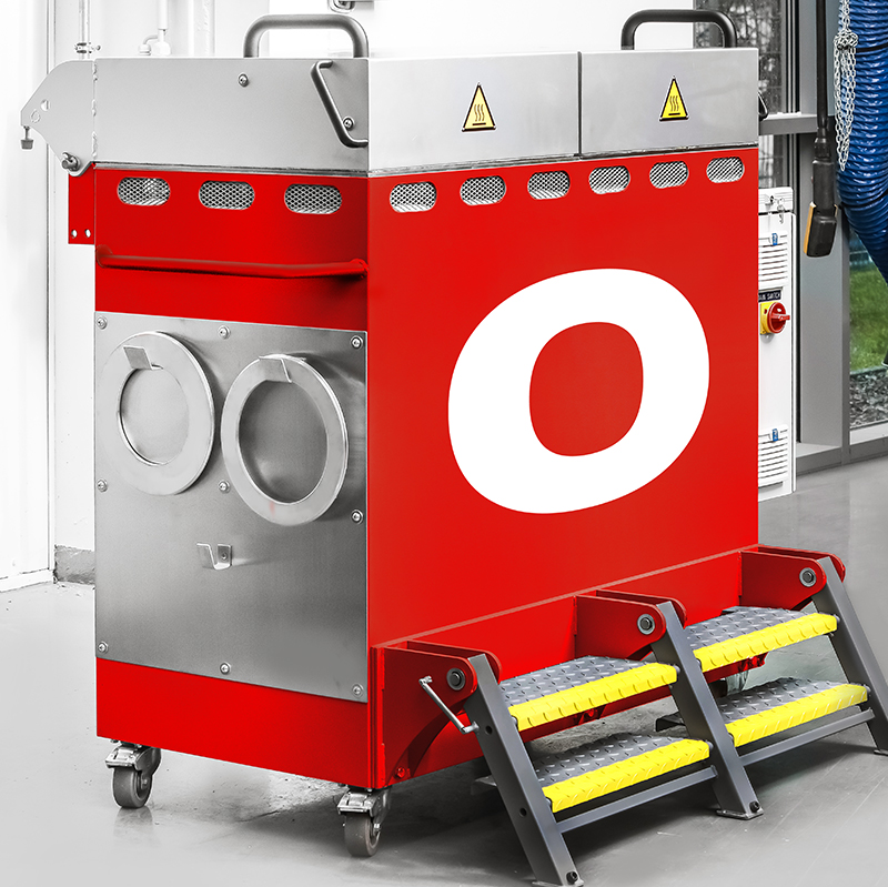

The completely mobile unit allows foundries to pre-heat ceramic components to the ideal temperature of 400⁰C just before use. Its clever design means it can be used anywhere, is easily transferred using a forklift, and can be placed directly next to the dosing furnace.
Featuring dual heating zones to accommodate the shape and dimensions of the Westomat dosing tubes and funnels, and to heat the two components independently if required, the pre-heating station is also a much safer alternative to improvised heating solutions that often pose a risk to the foundry teams using them.
