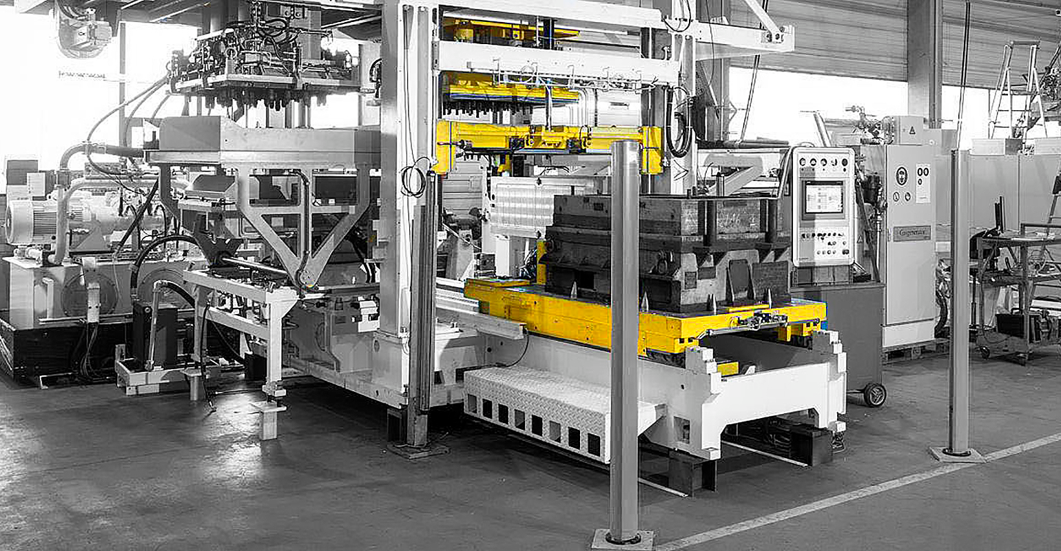

LAEMPE MÖSSNER SINTO is offering a software package with "apps" for recording, storing, and visualizing product and operating data. Users of the Laempe Digital Cockpit (LDC) can track production reports, availability, monitoring, shift book, mixer data, and cycle monitoring. By permanently analyzing the plant data, it is possible to calculate the overall equipment effectiveness (OEE), the essential key figure in foundry operations, according to Laempe.
As detailed by the developer, the LDC fits seamlessly into users' routines without changing the previous workflow. Because the LDC is designed as a web-based application, no additional software needs to be installed. The software is workplace-independent, cloud-capable and can be accessed via any internet-capable end device. The software, including the applications themselves, is located on a box PC that is conveniently connected ("plug and play") to the machine and the PLC data interface via a network connection.
The LDC helps production managers, maintenance staff, and operators to monitor all production parameters, machine availability and speed, production quality, and to obtain evaluations of historical periods and error logging in the form of a shift book. Over time, thanks to its various entries, the shift book becomes a knowledge database, including recommendations for action in the event of recurring faults. In this way, the LDC contributes to the transfer of knowledge within the company.
