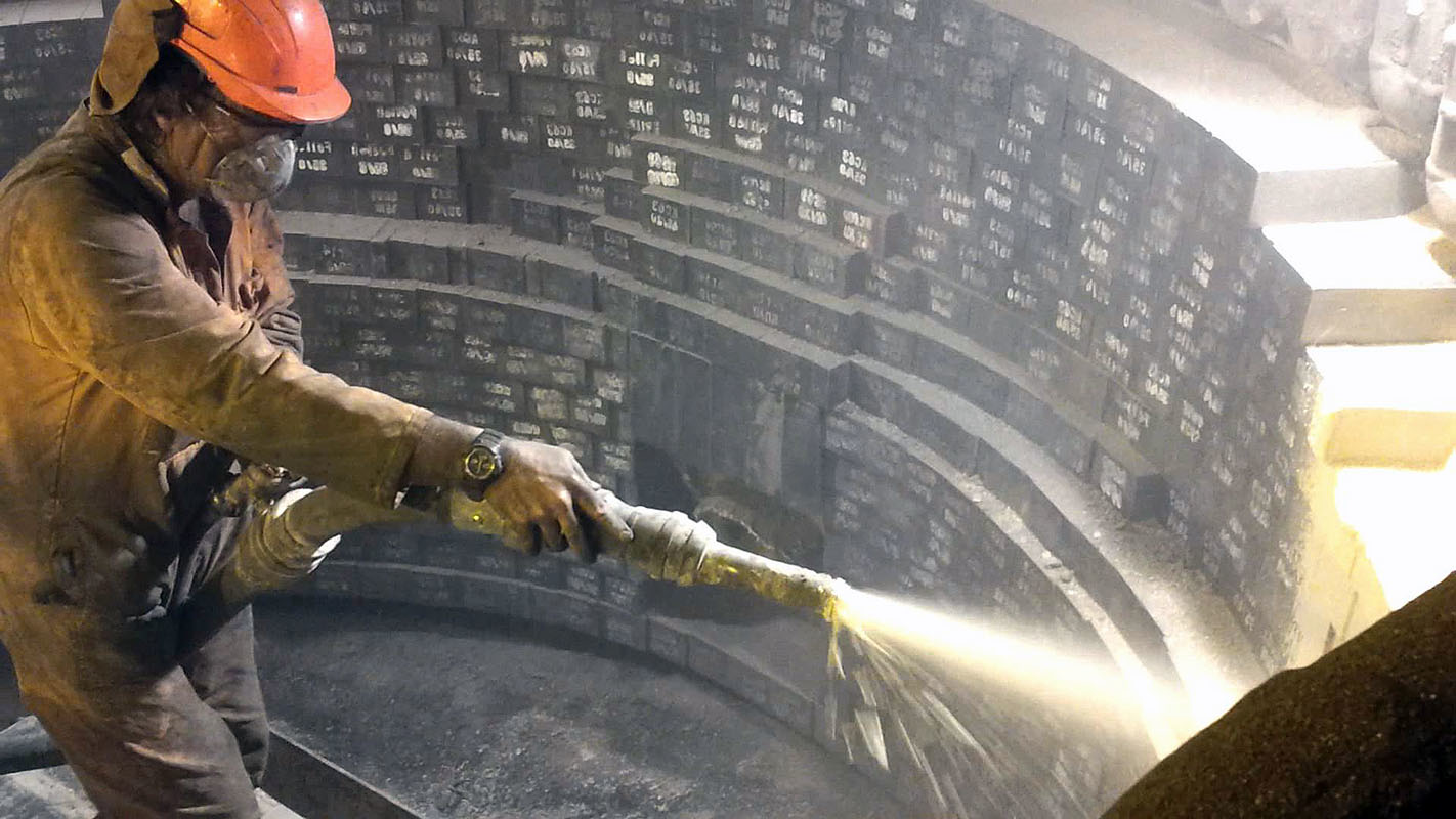

Shotcreting promo

“Considerable amounts of multiple materials must be ordered and delivered to the job site because the installation methods that are required aren’t known until the furnace is shut down and can be closely inspected,” according v.p. - Engineering Jens Decker, who added that the new series offers quality and consistency for all common installation methods – casting, pumping, gunning, ramming, and shotcreting.
