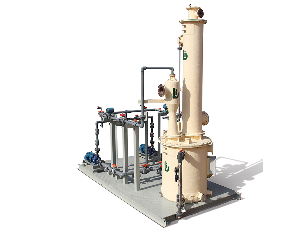

Pre-engineered and skid-mounted, complete with recirculation pumps, piping, entrainment separators, polishing scrubber, instrumentation, automated controls, etc.
BIONOMIC INDUSTRIES INC. is offering the Series 6500 jet scrubber as a fully integrated, pre-engineered, skid-mounted package, complete with recirculation pumps, piping networks, entrainment separators, polishing scrubber, instrumentation, automated controls and more – all factory assembled and tested to lower engineering, installation, and project costs significantly, while reducing lead times for quicker installation and on-time operation.
Units for outdoor installation are available with a freeze protection package for operation in cold weather climates, and all systems are complete with all necessary dimensional, weight, and instructional information, along with a system P&ID and process flow diagram, giving all material balances.
Series 6500 jet scrubbers are suitable for low to moderate gas volumes — from 5 through 60,000 cfm when gaseous and/or particulate contaminant removal is required. The jet scrubber creates its own draft to eliminate the need for a fan, in most cases, resulting in cost savings and system simplification.
Inherent with this design, gas is scrubbed with no bypass, resulting in a scrubber that can be used for large turndowns in gas flows. The scrubber uses a high scrubbing liquid-to-gas ratio, which also makes it a preferred choice for treating high concentration gas streams to reduce the resultant exothermic reaction temperature rise of the scrubbing liquid.
Series 6500 jet scrubbers are available in single and multiple stages, or can be combined with a Series 5000 Packed Bed polishing scrubber (as shown) with additional transfer units to meet extremely high gaseous contaminant removal efficiencies. A selection of entrainment separator types – baffle, cyclonic and fiber, or chevron blade modules – mean that the Series 6500 Jet Ejector Venturi Scrubber handles a range of pollutants efficiently. All separator types can be integrated with scrubbing liquid recycle tanks in capacities and configurations specifically designed to meet a particular application.
