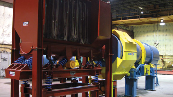

The integrated package includes a Didion® Rotary Separator / Metal Reclaimer and a Conveyor Dynamics Feed Conveyor, with a dust-tight front-end Load Hopper.

The Didion Rotary Separator/ Metal Reclaimer, loaded for processing.
The Didion Rotary Separator/ Metal Reclaimer with a variable jet burner to remove moisture.
To recover metal fines from their operation’s waste stream, the foundry purchased a Didion® Rotary Separator / Metal Reclaimer with a variable jet burner and a Conveyor Dynamics Feed Conveyor.  This system was designed with a dust-tight Load Hopper to be loaded by a front-end loader and metered into the Didion Rotary Separator / Metal Reclaimer.  To-date, this un-manned, stand-alone system, installed at a location outside the plant (close to the charging/melt department) has reclaimed over 2,000 tons of valuable metal — material that otherwise would have gone into a landfill as waste, and a lost opportunity for cost savings.
