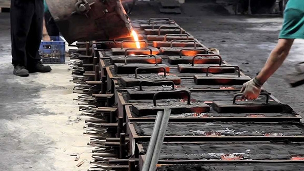

Shaking out castings is done in different ways, according to a foundry’s specific molding operation, and mold cooling may require hours or even days for batch production and larger castings. There is much to be learned about the process: In general, shakeout timing is not calculated, and it is determined mainly by older, experienced employees using very safe operating practices (i.e., a long time.)
What happens during the shakeout? First, the cast iron in the mold will transform its structure from austenite to ferrite (or pearlite, bainite or martensite.) This initiates a transformation stress. The amount of stress depends on the final structure: transforming to martensite leads to the highest stress; transforming to ferrite to the lowest stress level. Austenitic materials have no transformation and will not suffer from transformation stress.
Second, the casting will suffer from thermal stress. Thermal stress is directly related to the temperature difference between casting sections. This temperature difference may exist in areas with different section thickness, and in areas subject to non-homogeneous cooling (localized cold air stream, part of the casting still in sand, etc.)
These two stresses will combine, and if the total stress exceeds the tensile strength of the material, at each temperature between start of shakeout and room temperature cracks will form and (in the worst case) fracture may happen.
But, for the casting, what is the difference between shakeout and heat treatment cooling? Only that the heat treatment cooling is set up by using the Continuous Cooling Transformation (CCT) diagrams of the material involved, and controlled in order to get the correct structure (cooling rate) without cracks or fracture (homogeneous cooling, whatever the cooling rate, all over the casting.) Why cannot this be done for shakeout cooling?
