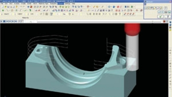

Victaulic’s pattern shop is increasingly reliant on Mastercam’s high-speed toolpaths to reduce machine cycles and tool wear. Operations supervisor Bill Nagle estimated that run times with high-speed machining have been reduced by 60%, and that tools are lasting at least 25% longer.
Mastercam CAD/CAM software is used to program mills and lathes at Victaulic’s R&D lab, to manufacture prototypes, and at its Tech Center to produce tooling for metalcasting.

About 20 miles away from corporate headquarters, another lean Victaulic manufacturing operation, the Tech Center, is running full speed to manufacture the tooling that will be used to make for castings for grooved pipe joining products. Being able to program toolpaths in an intuitive CAM environment is essential to keeping the work flowing. Further, the pattern shop is becoming increasingly reliant on high-speed toolpaths to reduce machine cycles and tool wear. Operations supervisor Bill Nagle estimated that run times with high-speed machining have been reduced by 60% , while tools are lasting at least 25% longer.
Recently the pattern shop has advanced its productivity further with the addition of its own high-speed, five-axis machining center — an Okuma NB56V with Supernurbs (on-board NURBS interpolation). NURB is an acronym for “non-uniform rational B-splines”: These are mathematical instructions in the software that allow Mastercam to call out the smooth curves and surfaces that impact surface finish. On-board NURB interpolation takes execution of these instructions out of the postprocessor and puts them into the controller’s firmware, so they can be executed at much higher speeds.
Nagle said this marriage of hardware and software has allowed Jerry Miley, Tech Center CNC programmer, to conquer complex geometries, eliminate multiple set-ups, reduce machine cycles, and use advanced coatings to improve tool performance, wear, and improve surface finish, dramatically. Manual grinding and polishing has been reduced by as much as 90%.
