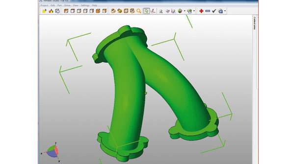

A CAD iteration of a finished part prior to 3D printing of a prototype or pattern

1.  3D Printed Patterns: Think renboard, wood, or metal patterns.  With many 3D printing technologies, this is the most accessible application.  You, your pattern shop, or your customer, can design tooling from anywhere in the world, and you can print it out on demand.
The finished part is a single part that confirms the validity of a metalcasting production process that incorporates 3D printing.
Tooling can be made from a variety of composites, plastics, or metals.  Turnaround time can be as short as a few hours from the time of receiving the files.  Core boxes can be made the same way, sometimes simultaneously with the mold tooling.  Most good foundries already know how to use a pattern board, so there isn't really a learning curve at all for implementation.  If you don't want the equipment, get your pattern shop to pony up for the hardware.
