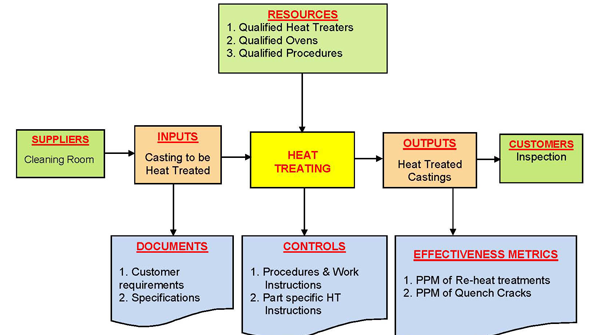

Figure 1 A SIPOC diagram of a heattreatment process SIPOC suppliers inputs process outputs and customers is a tool that summarizes the inputs and outputs of one or more processes and is used in TQM Six Sigma and Lean manufacturing programs to collect and analyze data

Step 5: The next step is to create a SIPOC diagram for the various sub-processes in the foundry, which also gives the performance metrics of the process.  This is the difficult part.  The foundries should be able to correctly identify the most effective metrics for the process and collect data at the appropriate frequency, monitor the metric, and show continuous improvement in the process metric. The metric should not only have the appropriate goal (daily, or weekly or monthly), but also should have a goal for continuous improvement.
An example of the SIPOC diagram for the heat treatment process is shown in Figure 1.
