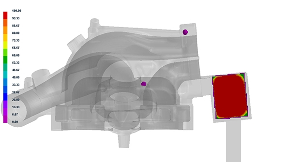

Epcor used ESI Group’s QuikCast casting simulation software to evaluate the initial mold design.  They were able to identify several areas where the simulation showed porosity would be a problem. Engineers ran a series of alternative mold solutions while adding risers to feed molten metal to compensate for shrinkage in critical areas of the mold.
“We constructed a design that the simulation said would work nearly perfectly,” said Mike Maratta, plant manager for Epcor Foundries. “The result was 98% first time throughput for the initial parts, much better than you would expect to see on a complex part like this prior to simulations.”

Simulating initial mold design — Paul Kiefer, senior design engineer for Hitech Shapes and Designs (an affiliate of Epcor Foundries) performed the simulation of the EGR valve casting process. He began with a CAD model of the valve provided by the customer, converting it to an STL file and importing that version into QuikCast.
Next, he created the initial design of the mold with the software’s user interface. Then, QuikCast produced a block-structured mesh. Kiefer defined the process parameters along with material properties, fluid and thermal conditions. From that data, the software produced a graphic simulation that helped Epcor to visualize mold filling and solidification, and eventually to view the resulting part.
“When I simulated the initial mold design, it was obvious that porosity was going to be a challenging issue,” Kiefer said. “Viewing the simulation results, I was able to determine that in several critical areas the aluminum was solidifying early in the cooling process, creating isolated pockets of liquid metal that could not be fed as they solidified.
“Most metals are less dense as a liquid than as a solid,” he continued, “so castings shrink upon cooling. As these pockets solidified, it would not be possible to replace the volume lost to shrinkage and the result would be porosity that would create leak paths and potentially cause the part to fail. The porosity would have been detected in physical testing and additional process trials, with a very real possibility that the automobile manufacturer’s line would have to be shut down due to lack of parts.”
Addressing porosity — Once the baseline simulation model was set-up, the next step was to begin changing to the simulation model to eliminate porosity in the virtual casting. Kiefer considered several different approaches to address the problem, including opening up the gate to the part, changing the part orientation, or adding risers. He felt the most promising approach was to add risers, which are reservoirs built into the mold that feed metal to the casting as it solidifies.  The result is that shrinkage occurs in the riser and not the casting.
Risers must be designed carefully to work effectively: a riser must cool after the section of the part that it feeds. And, a mold must be designed so that the area of the casting connected to the riser is the last to solidify.
Guided by the simulation results, Kiefer added risers, one at a time, to the areas where shrinkage was predicted to be a problem. Each time he modified the mold design, he reran the simulation to validate the riser design and evaluate the shrinkage of the area serviced by the riser. Successive simulations showed that as the isolated areas in the mold shrank, they drew metal from the risers, which avoided the formation of porosity.
After running three additional iterations, the simulation showed that the problems had been resolved and that the mold would produce quality cast parts consistently.
