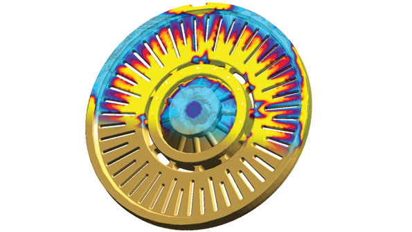

A MAGMASOFTsimulated core reveals cooling and solidification processes before any metal is poured
