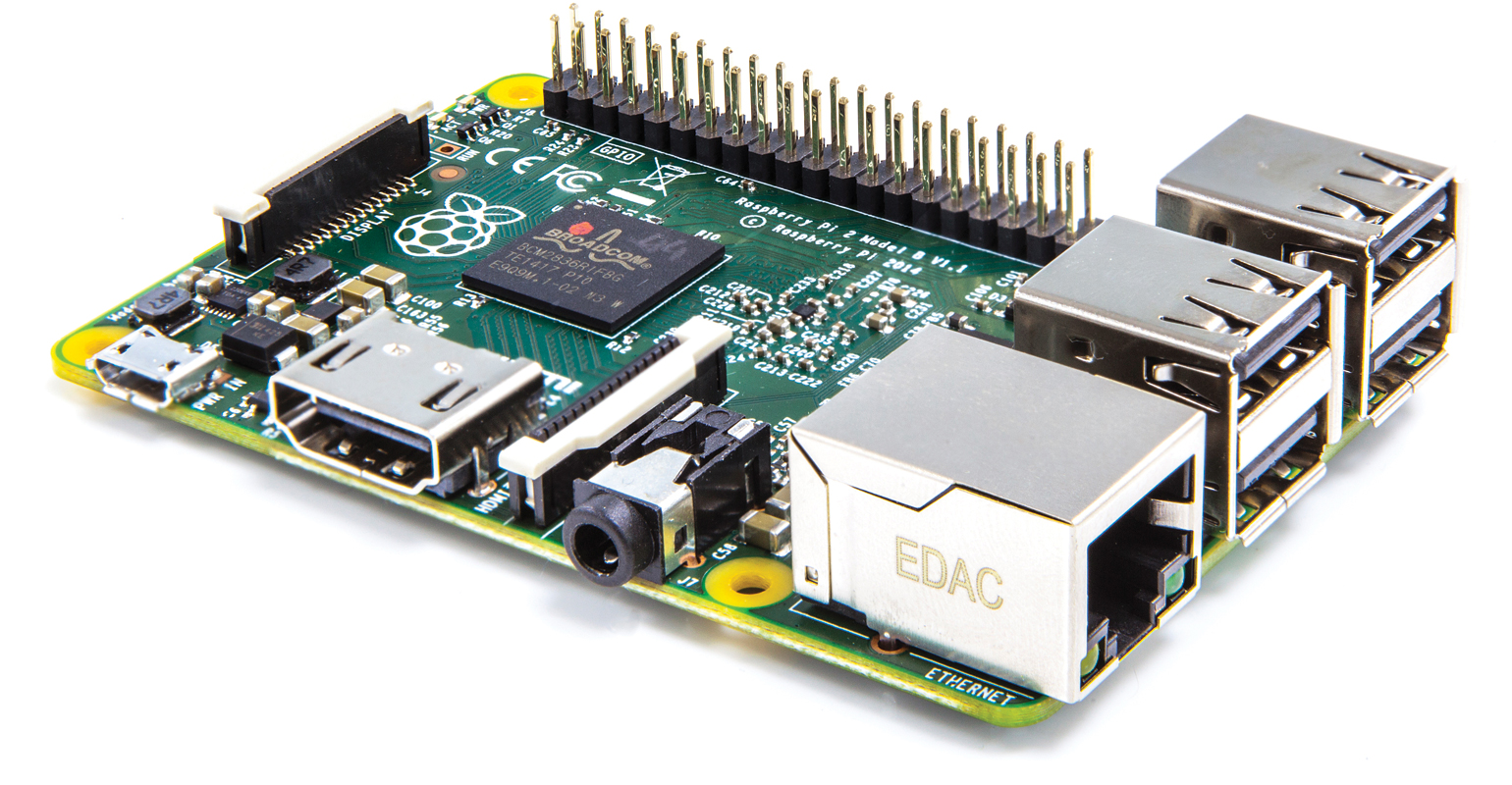

1) The Raspberry Pi is an inexpensive Linux computer that is smaller than a deck of playing cards.  It hooks into a display monitor via an HDMI cable and uses a browser to access the internet.  (Raspberry Pi also is Windows IoT Core-compatible.) This set-up allows the display to communicate with any browser-based software system, including Odyssey ERP.   Eck Industries Inc., Manitowoc, WI, uses this technology duo to collect and input shop floor data.
