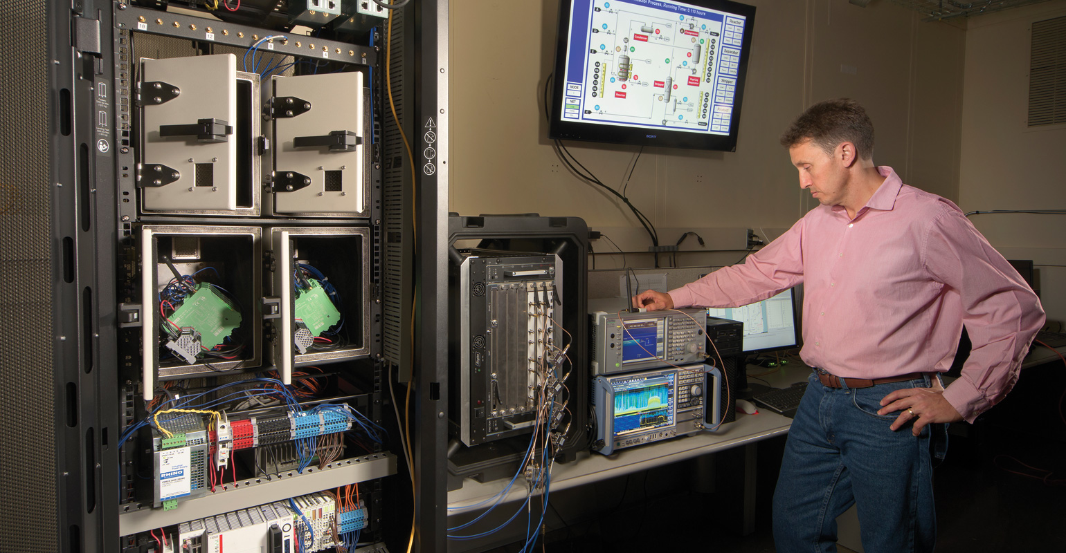

NIST R. Candell, testbed

NIST is working with private-sector collaborators and standards organizations to address these issues, to make industrial wireless communication more compatible with manufacturing operations. Last year, NIST and the Institute of Electrical and Electronics Engineers (IEEE) organized a technical working group to develop “a succinct yet comprehensive, easy-to-use reference guide and best practices manual for anyone, from control engineers to factory managers, to integrate a robust, safe, reliable and secure wireless system into their unique industrial landscape,” according to Rick Candell, an electronics engineer at NIST’s Engineering Laboratory.
Candell said the new guidelines will direct users clearly through each step to achieving an optimal wireless communications program for specific operations. Following the step-by-step references are several best-practice case studies to show what has worked to improve and optimize wireless in different factory situations.
“For example, one scenario looks at a common but often overlooked problem when using wireless communications (e.g., Bluetooth devices) … that personnel are using,” Candell said. “The guide tells how to identify the sources of such interference, measure how they impact factory operations, and then use the data to choose the most appropriate solution from those described in the text.”
