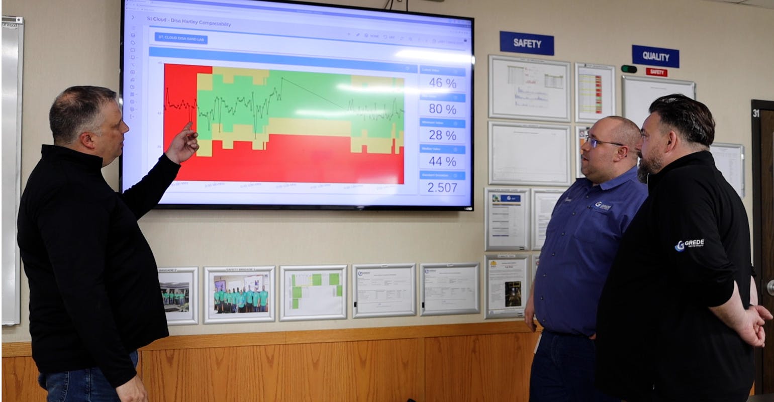

Monitizer | Discover’s alarm functions enhance production control and support inexperienced users. If an issue needs attention, the system contacts different groups of people in different waves, sequentially, depending on how the problem develops, and whether the first alerted group reacts. “If a machine runs outside its ‘green’ operating zone, the supervisor gets alerted,” according to Grede St. Cloud foundry general manager Bart Hoemann.

A real-time digital view. Monitizer is a modular IIoT platform designed to collect data from production equipment from any supplier, across multiple production lines or global sites. It aggregates, stores, and displays live and historical data through customizable, user-friendly dashboards and key performance indicators (KPIs.)
“The standard dashboards were built by people who know foundries,” emphasized Grede’s Matt Deyarmond, IoT Process and Control Lead. “They probably saved us over 80% on our set-up time. The system is simple to use and navigate, and it was easy to make minor changes ourselves.”
The real-time data and KPIs enhance process visibility and make it possible for Grede to react quickly and address any issues immediately. This superior quality of process control is driving major production improvements, according to the group.
Monitizer | Discover’s sophisticated alarm functions further enhance production control and support inexperienced users. If an issue needs attention, the system contacts different groups of people in different waves, sequentially, depending on how the problem develops, and whether the first alerted group reacts.
“If a machine runs outside its ‘green’ operating zone, the supervisor gets alerted,” explained Bart Hoemann, General Manager, at Grede’s St. Cloud foundry. “If it exceeds its control limits, it escalates to the quality manager. Exceed control limits five times and the plant manager gets notified.”

Grede found the secure system simple to use and navigate. “I can click into the plant dashboards wherever I am – in the office or on a plane,” she said. “We can deep dive into any one of our foundries, drill down into, say, sand compactibility; or step back and look at our corporate view to instantly see how all the plants are running.”
Process visibility drives improvements. “One of our foundries used Monitizer’s information to cut scrap by 50% by reducing sand inclusions. And, of the foundries that are live with Monitizer, 100% of them report scrap reductions.”
