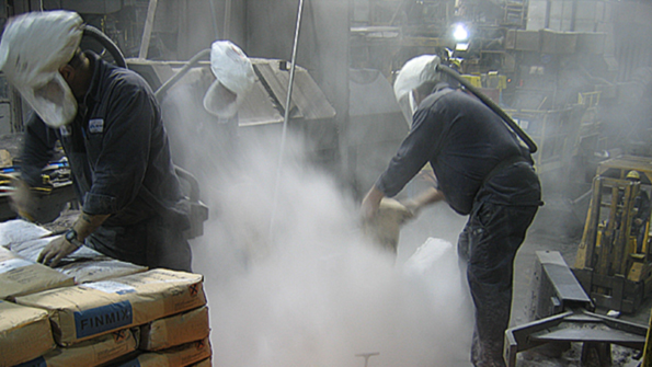

Piqua Champion Foundry in Piqua, OH, was cited recently by the U.S. Department of Labor’s Occupational Health and Safety Administration for 20 violations of federal safety standards, including seven repeat violations and 13 serious violations. The charges carry proposed penalties of $57,140.00.

The federal agency stated that during a January 2014 inspection it determined that nine workers at Piqua Champion Foundry had been exposed to dangerous levels of silica dust, respiratory hazards, and unsafe work conditions in process like casting grinding and furnace relines.
OSHA stated the foundry did not provide medical evaluations for employees using respirators; failed to monitor supplied breathing air for carbon monoxide; and did not properly mark respirators that needed new filters.

The “serious” violations concern workers’ exposure to airborne silica dust levels higher than the permissible exposure limit for a shift; failure to implement controls to reduce exposure; and to train workers on silica hazards. Crystalline silica exposure has become an area of safey emphasis for OSHA in recent years. It noted that inhalation of small crystalline silica particles puts workers at risk for silicosis, lung cancer, chronic obstructive pulmonary disease and kidney disease.
Last fall, the agency proposed a new safety rule to protect workers exposed to respirable crystalline silica, a rule it estimates would save nearly 700 lives and prevent 1,600 new cases of silicosis annually.
OSHA directs workers to protect workers from dangerous silica dust by providing engineering controls, respiratory protection, training and monitoring exposure levels.
