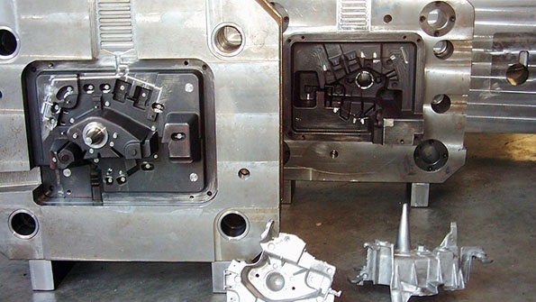

Global markets have continued to put pressure on the price of diecastings, requiring manufacturers to find new opportunities to manage costs.  Excluding labor, casting dies are one of the largest production expenses for automotive suppliers, and a very critical business item to ensure part quality and on-time delivery.  If a die fails before its life has been reached, production cost will increase and the potential for loss of business suddenly rises, if quality or delivery has been impacted. The single most important factor in determining the performance of die steel is the heat treatment process. To ensure the dies achieve their desired performance, confirming proper heat treatment of the die steel is essential. This guide will help casting personnel understand how to interpret a furnace chart and how this data can be used to judge if a proper heat treatment has been performed.

Heat treating H-13 die steel is divided into four major steps: preheating, austenitizing, quenching and tempering. Each step has a specific function with unique thermal requirements to optimize the steel’s mechanical properties.
