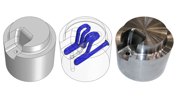

Tooling systems made by additive manufacturing that incorporate conformal cooling channels reduce molding and diecasting cycle times, polymer warpage, and casting porosity, and promote greater component life and wear resistance, according to HTS.
HTS International Corp., a developer and manufacturer of advanced tooling systems plans to build a global headquarters and manufacturing center in eastern Tennessee, a $21.4-million project that would employ about 200 workers over the coming four years.  HTS molding, tool, and die products are used in diecasting, injection molding, extrusion, and hot stamping processes. The new operation also will include a research and development lab, metallurgical lab, and an expanded additive manufacturing center.
HTS uses a proprietary additive manufacturing process called innovative Metal Fusion Technology (iMFT) to produce a series of mold and tooling products called the innovative Thermal Management Solutions (iTherm) series. In development for more than a decade, iMFT has been in industrial use since 2014.
The iTherm line of tooling systems are engineered in various tool steel alloys (H11, H13, and P20, among others) with conformal cooling channels that help to lower cycle times, reduce polymer warpage, reduce casting porosity and soldering, and prolong component life and wear resistance.
