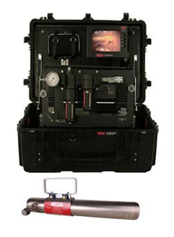

The LENOX INSTRUMENT CO. portable furnace camera diagnostic system provides an easy and economical way to achieve real-time, color video monitoring and digital recording of combustion and process control in high-temperature furnaces. It’s a mobile system so operators can use one unit for diagnostics or monitoring and recording of several individual furnaces, using any available 3.5-in. (89-mm) opening.
The portable high-temperature camera system provides engineers and operators clear, high-resolution images of burner flames, refractory condition, and material alignment and movement inside walking-beam, walking-hearth, pusher furnaces, or rotary hearth, annealing and other thermal treatment furnaces.
The Lenox portable furnace camera diagnostic system is entirely self-contained, consisting of an air filtration and power system, water hoses, and 8-in. CCD color monitor packaged in a durable case with telescoping handle and wheels. The furnace camera’s stainless steel housing employs a steel triple wall laminar flow for efficient water-cooled protection of the CCD color camera and integrated low consumption air-purging to keeps the lens clear of particulate, enabling extended operation in hostile environments up to 3,500°F (1,927°C). A radiant heat shield and mini-digital video recorder with a LCD screen are available as options.
