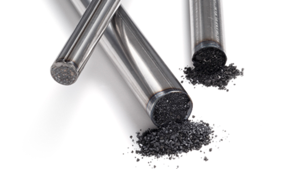

Treating ductile iron with cored wire solves all of these problems, and provides some additional benefits.  The cored-wire method for treating ductile iron is a proven technology that is gaining acceptance in foundries across the globe.   The alloys — magnesium, FeSi, rare earths, calcium, etc. — are encased in a steel sheathing and delivered to the foundry in an easy to use cage.

Now, let’s go deeper into this issue.  How can cored wire solve your specific problems while simultaneously improving your ductile iron?  Since cored wire is produced with a high percentage of magnesium (~30%), the treatment alloy addition rates are significantly lower than traditional MgFeSi practices (pour-over, tundish, sandwich, etc.)  Normal alloy addition rates associated with cored wire are as low as 0.4%.  This lower addition rate has several benefits: lower silicon addition, lower temperature loss during treatment and cleaner, more fluid ductile iron.
