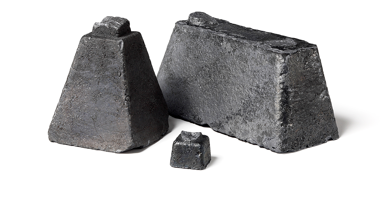

Q: We have quality-control issues with some castings that feature thin sections. We pour gray iron castings ranging from 200 to 300 lbs., and some of these include thin-section details. In some instances, we discover that the thin sections include undesired graphite structures — types D and E — and some carbides. Is there a recommended process or additive product that would help us to improve the graphite structure to Type A, and achieve a strong inoculation effect that would prevent those carbides?
A: You will be glad to learn that there is such a method. Types D and E graphite and carbides in thin sections of gray iron castings is an issue that many foundries have to deal with. Both of these undesired structures come from the high solidification rate of the molten metal. This means that the metal solidifies too quickly, and as a consequence it is not able to establish the desired structure (i.e., Type A, and with no carbides.)
The product that addresses this issue is known as an in-mold inoculant, and the process for applying it involves anchoring a solid, FeSi inoculant alloy structure in the sand mold. This method of inoculation has various benefits: it will promote a Type A graphite structure; there will be no inoculation fade; and the cast part will exhibit improved mechanical properties.

Q: How can we introduce this practice to our process? Describe how in-mold inoculation would be accomplished?
A: It is preferable for the in-mold inoculant to be anchored in place before the molten metal fills the mold. It is possible to enhance the mold pattern to be able to introduce the in-mold inoculant product as the pattern is being filled with mold. In this way, you can have the mold anchored with the inoculant.
If that is not possible, then it is suggested to have a pouring basin on top of the mold and to anchor the product to the pouring basin. Then, as the molten metal is poured into the basin, the melt can be inoculated and poured immediately into the mold.
