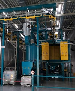

To ensure gentle but also fast and effective deflashing in continuous flow, the model RHBD 13/18-So continuous feed spinner hanger shot-blast machine is equipped with eight special turbines, each with an installed power of 11 kW. The turbines contain extra wide throwing blades that generate a particularly broad blast pattern.
Furthermore, contrary to the standard placement of the turbines on one side of the blast chamber, the turbines were placed on both sides. This duplex turbine placement, together with the broad blast pattern, generates a gentle blast operation, which significantly minimizes the risk of warping. But the comparatively high throughput for the blast media required for efficient deflashing and cleaning the light metal components ensures a fast and effective shot-blasting operation.
Another feature that prevents workpiece warping is that the workpiece carrier holds 60 to 80 components, and it not only rotates throughout the shot-blasting process but also oscillates back and forth in three positions. This guarantees that flashes and burs are safely removed, even in difficult-to-reach areas like undercuts.
To prevent the blast media – very small aluminum cut wire – from being sucked out of the shot-blast machine by the exhaust air flow and to maintain the required optimum operating mix, the dust collector and the cascade air wash separator were technically modified. The wet dust collector is fully compliant with the ATEX requirements for machinery and workplace safety in the European Union.
Necessary maintenance work is facilitated by multiple connections for cleaning equipment at different sections of the shot-blast machine.

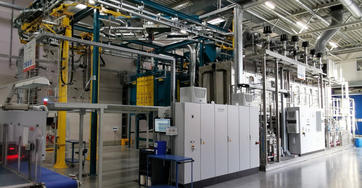

A power-and-free handling system ensures easy and trouble-free transport of the workpieces. At the load/unload station the height of the workpiece carrier can be adjusted to the height of the respective operator, thus allowing ergonomic and comfortable working conditions.
Moreover, generously laid-out buffer sections in the transport system permit continuous operation, even during breaks and rest periods. To ensure absolute safety of the personnel, all hazardous areas around the shot-blast machine are equipped with safety mats instead of the usual sensors and enclosures.
