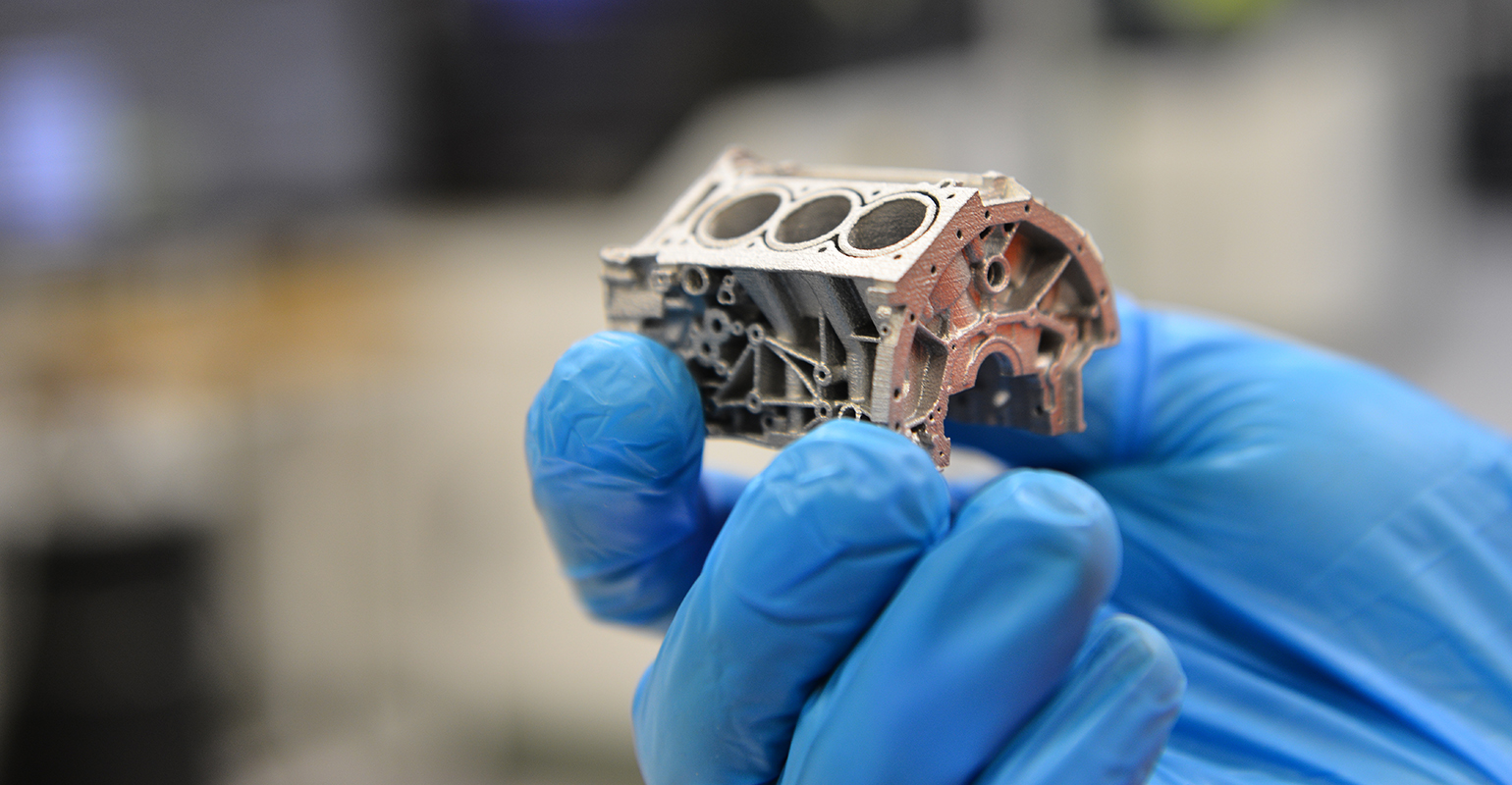

This aluminum 6061 engine block model demonstrates the high resolution and geometric control that can be produced in a new patent-pending binder jet 3D printing and sintering process developed by ExOne and Ford Motor Co.

The automaker and additive-manufacturing specialist have co-developed a binder-jet and sintering process for aluminum 6061, pointing the way to high-speed production of light-weight, complex parts with densities greater than 99%.
Ford Motor Co. and The ExOne Co. are seeking to patent a 3D-printing process for automotive aluminum alloy 6061 they co-developed, involving a binder-jet process and sintering which they claim, “delivers properties comparable to diecasting.”
Aluminum 6061 contains magnesium and silicon elements, and it feature good mechanical properties and good weldability. It is commonly extruded, forged, and sometimes diecast. Ford and ExOne contend their process for binder-jet printing and sintering aluminum 6061 results in parts with densities greater than 99%.
