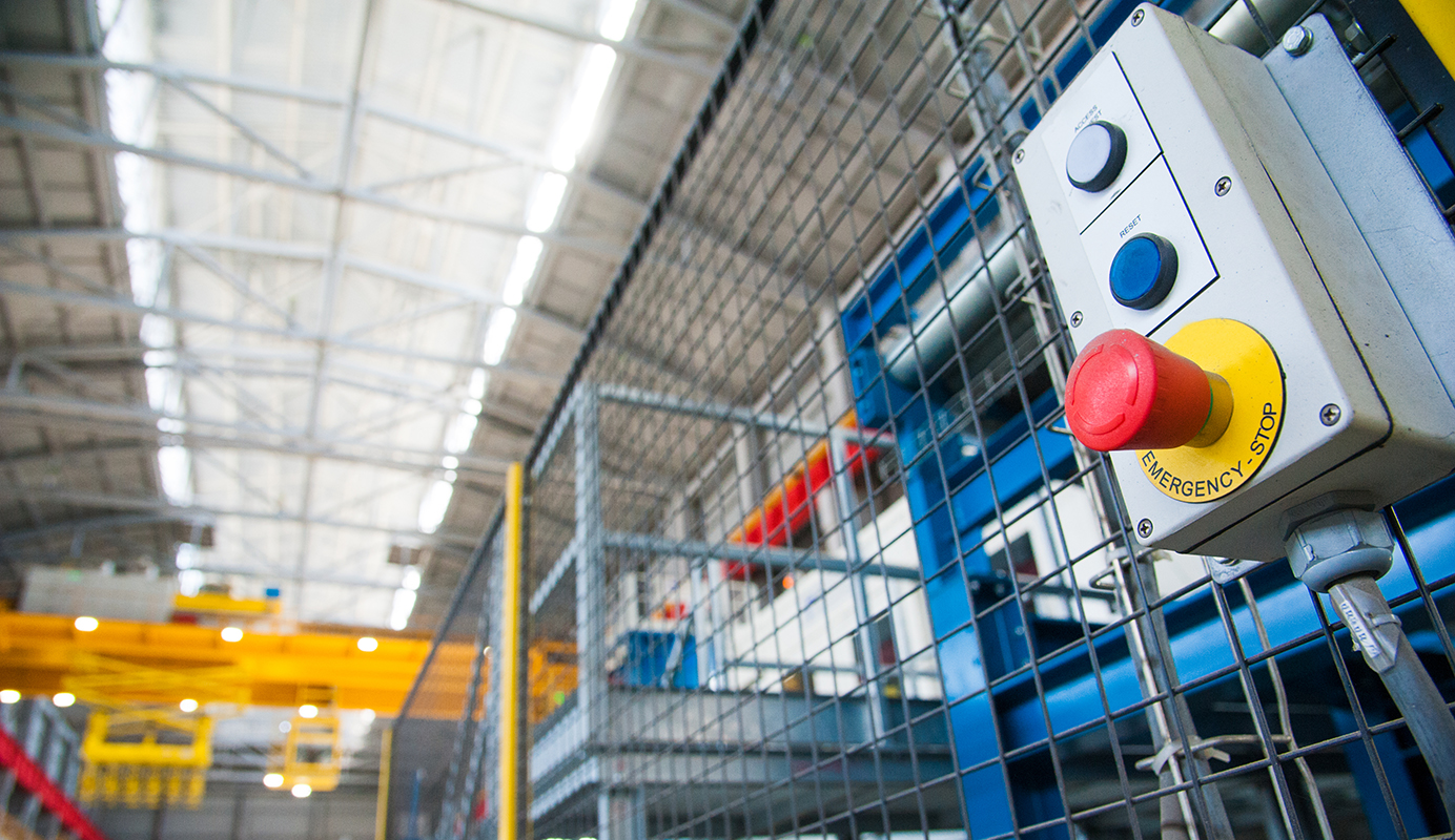

General Aluminum Mfg. Co., an automotive aluminum castings manufacturer, is facing charges for 38 alleged violations of workplace health and safety regulations by the U.S. Dept. of Labor’s Occupational Safety and Health Administration. The charges may bring penalties totaling $1.67 million, according to an OSHA statement.
In an incident on March 30, a 43-year-old worker was loading a part into a machine when he was struck by a barrier door and killed. While the barrier door is meant to protect workers, a malfunction in the door’s optic control that existed previous to the accident was found to be the cause.
General Aluminum Mfg. has 15 business days from receipt of the citations and penalties notification to comply, request an informal conference with OSHA's area director, or contest the findings before the independent Occupational Safety and Health Review Commission.
The OSHA investigation identified problems with machine guarding and a lack of lockout/tagout throughout the plant, and it contends that General Aluminum knew of these problems and failed to address them effectively.
Also, the agency maintains the company lacked effective process safety management procedures and failed to protect employees from burn and explosion hazards, provide personnel with appropriate protective equipment, train workers adequately about hazards and safety procedures, record employee training and develop emergency action plans.
OSHA issued four repeat, 18 willful and 16 serious safety and health violations and placed the company in its Severe Violator Enforcement Program following the fatality inspection, and two others opened as a result of employee complaints to inspectors.
