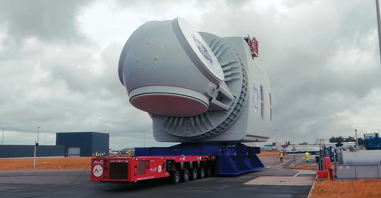

A nacelle, or housing, for a GE Renewable Energy Haliade-X series wind turbine.

Large iron castings are the primary structural element for wind turbines – and producing those castings is a specialized capability for a limited number of iron foundries. Last year GE Renewable Energy participated in a research project with voxeljet AG and Germany’s Fraunhofer IGCV research institute, involving 3D printing of the large-scale sand molds required to cast those housings.
GE’s involvement supports its Haliade-X series of wind turbines, described as the most powerful offshore turbine now available, rated for a generating capacity of 14-, 13-, or 12 MW. As the turbines are designed with a 220-meter rotor and three 107-meter blades, the Haliade-X nacelle (i.e., housing) is designed for structural and mechanical reliability, as well as environmental durability in offshore installations.
