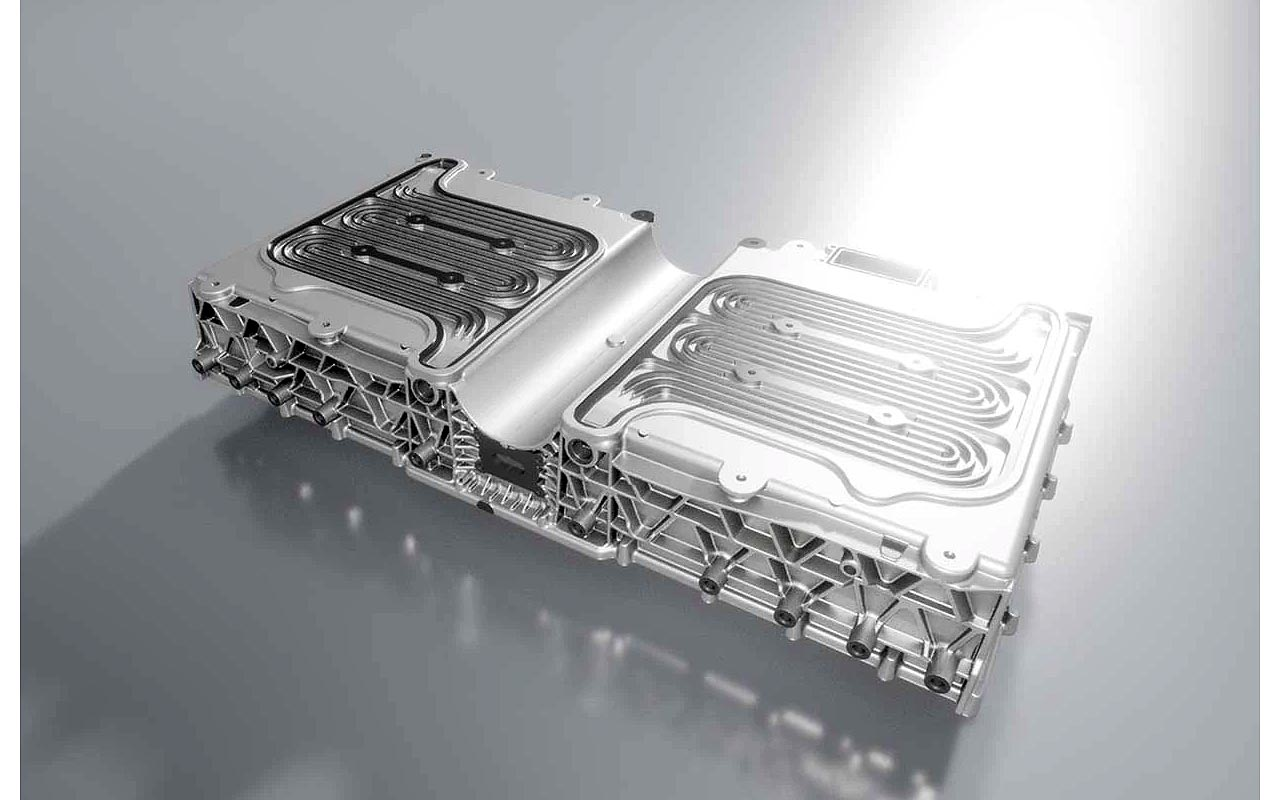

An EV battery housing developed by GF Casting Solutions in partnership with Renault.

Electric drive components –Lightweight designs achieved through simulations and according to bionic principles can deliver significant decreases in overall vehicle weight. Increased design flexibility allows more integrated functionalities in components. An example of lightweight design optimization are battery housings for hybrid-electric vehicles. The freedom of design provided by the casting process allows manufacturers to save material wherever possible, including integrating attachment points or cooling circuits into the design for series production – making it ready to install upon delivery.
GF Casting Solutions jointly developed a lightweight diecast battery housing for Renault’s two hybrid models,  made of an aluminum alloy, providing high functional integration as well as an integrated cooling circuit.
