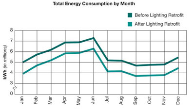

With the new lighting system, Lufkin Industries is reducing its monthly energy consumption significantly, saving more than $800,000 annually.

The audit concluded that nearly one-third of Lufkin’s total energy consumption was attributable to its lighting system, which included high-wattage, metal-halide and high-pressure sodium (HPS) fixtures for high-bay installations, as well as magnetic, T12 lamps and ballasts for low-bay and office lighting.
Lufkin Industries’ new lighting system resulted in an impressive 29.8% reduction — or 11,938,207 kWh — in lighting-related energy consumption.
A complete lighting retrofit, converting Lufkin to a more efficient system with custom fixtures (four-lamp and six-lamp T5HO for high-bay and T8 fixtures with electronic ballast for low-bay and office lighting) was proposed. Additionally, occupancy controls (turn the lights off when spaces are unoccupied) were recommended throughout the facilities. The retrofit would take place at five of the company’s facilities in and near Lufkin, TX: the corporate office, the foundry, the Buck Creek location in South Lufkin, a gear repair facility, and the power transmission plant. The estimated reduction in energy usage was 11,938,207 kWh — 18% of the company’s annual energy usage.
That estimated decrease would save $800,000 annually and qualified Lufkin for two rebate programs totaling $675,000. The company also received federal tax incentives totaling $100,000 through the Energy Policy Act of 2005. Also, Lufkin reduced its CO2 emissions by 16,958,929 pounds.
