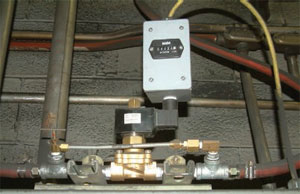

Cabinet cooler thermostat control with purge function
Retrofitting 68 cabinet coolers with thermostat controls and an integrated purge function cut the energy cost by over 50%.

Neenah Foundry retrofitted 68 vortex cabinet coolers that now use a small amount of purge air to maintain positive pressure within the cabinets at all times. Full air flow is used only when the thermostat calls for cooling. The electronic thermostat operates just like a standard programmable thermostat, activating only when the temperature inside the cabinet rises to a pre-set level, which prevents the cabinet coolers from needlessly running at full flow.
