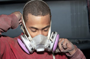

Foundries and diecasters have numerous reasons to provide effective respirators for their workers. Keeping those devices functioning effectively is part of their EHS responsibility.
A proper respirator maintenance program identifies an employee who will be responsible for cleaning, inspecting conditions, conducting repairs and ordering replacements. Each maintenance incident should be logged by the person conducting it.
