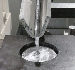

The different stages of the Liquid Forging process

Liquid Forging allows complex geometries to be produced with pore-free parts that minimize material waste. This process uses a pre-determined volume of molten metal that is poured into a die cavity and squeezed under pressure during solidification. This means that the final shape of aluminum alloys parts are formed with a single step.
The process produces parts that are able to achieve optimal design details with less material (e.g. lighter heat sinks), resulting in substantial savings. It also requires minimal machining for cost-effective manufacturing. Moreover, according to the developers, it is a “green” process that increases recycling of aluminum alloys into new products.
Liquid Forging was developed to address porosity in diecastings, the two-dimensional limitations of extrusion, and other drawbacks of current manufacturing processes. And, according to SIMTech, the new process can be scaled for highoutput industrial production. It is comprised of four steps:
Step 1 — Aluminum alloys are heated in a furnaces a 680°C to create a molten melt that is poured into a preheated die. Step 2 — A custom-fitted mold closes with direct pressure to create the near-final shape of the final product. Step 3 — The die mold and punch are held together until the shape of the final product is fully formed. Step 4 — Once the product is cooled, the punch is lifted and the final product is ejected from the mold.
