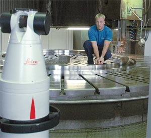

Until 2007, the foundry used conventional measuring instruments to verify dimensional standards, such as calipers or micrometer screw gauges. But, handling 6-m-diameter castings while using these tools is a complex task: the measuring equipment requires continuous attention and its accuracy must be maintained. Additionally, some shapes cannot be measured by conventional means, for example the radii and sloping surfaces that overlap. In those cases, diameters are theoretical dimensions of sections that do not exist on the casting and must be construed during measurement.
Faced with this situation, Otto Junker managers decided to measure dimensions directly on the turning machine using state-of-the-art, software-controlled coordinate metrology. The machined castings have to comply with the tightest of tolerances. “The ranges of accuracy we are dealing with here are quite incredible,” added Tigges. “Formed parts with a diameter of 4 m have to be accurate to 3/100 mm. In a very tough environment, this simply cannot be done using conventional methods.”

The handheld wireless scanner and probe supplied to Otto Junker by Leica Geosystems make it possible to measure a vast number of points, even at hidden or theoretical locations, more quickly and effectively.
The greatest challenge for users is to verify their own measurements. “Small cones with diameters of 2.5 m and a height of 15 mm at an angle of 10° are very hard to capture. But with a half-inch reflector sphere we can achieve very reliable results. The graphical display in the software is a huge help,” said Tigges.

When the part comes within 1.5 mm of the finished dimensions, it must be measured in cycles of three to four hours until the final dimensions are achieved. “In this way we can, and will in the future, work increasingly faster with the help of the Leica T-Probe,” said Tigges. “We have also discovered that we can only measure with great difficulty near the machine. The better option is to do it while the component is still mounted. We have so many crane and truck movements in the shop, so it is better if the tracker remains near the machine. Around the machine the floor plates are more stable and thicker.”
The laser tracker also alerted the team to other possible applications. The tracker was a great help when assembling a new turning mill, for example. “We measured the base for the machine where the table runs on an oil mat. These tracks have to be parallel to one another and are bedded by hand. Using the laser tracker, within a week and a half we had surveyed the tracks, and what we learned from the measurements led to significant savings in time and costs. The 63-metric ton table was quickly installed in the machine,” said Tigges. The tracker was also useful in checking the machine, too. Compensation had to be made for wear on the cutting tools. Precise measurement results can reveal the tolerances within which a machine is operating.
