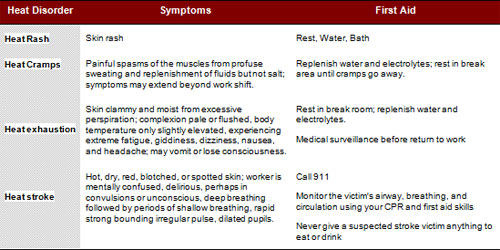

The nearby graph describes the symptoms and treatment of heat-related illness. It would be a valuable reminder to managers and workers.
