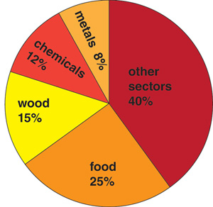

A study by the U.S. Chemical Safety Board analyzed sectors with recorded incidents of combustible dust fires and explosions from 1980-2005.
