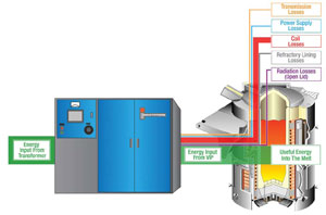

Fig. 1. A diagram of useful energy into an induction melting furnace.

In the induction melt shop, the high efficiency VIP® power supply powering the furnace typically has a low water temperature rise on the electrical/ electronic components. Thus, heat recovery for the power supply system is typically not economical. However, in some cases, this temperature rise is fed to a water-to-water heat exchanger feeding the furnace and raising the inlet temperature, thus enhancing overall recovery. While almost all the heat is produced in the melting furnace and, in most cases under full power, an expected 40°F+ temperature rise is common. This temperature level is lower than the drain temperature sensor range/furnace safety cutout. Typical furnace drain water runs in the 140°F temperature range. Some applications may be in the 150°F range or higher, based on the application and type of system.
While today’s furnaces offer high electrical efficiency, a sizable amount (20-30%) of the rated power can be recovered from the furnace coil water temperature generated by the I2R losses (current on the coil), as well as thermal refractory loss in the furnace. Based on one furnace iron melting operation, Figure 3 shows the hourly BTUs available at 75% recovery and 75% power supply utilization.
