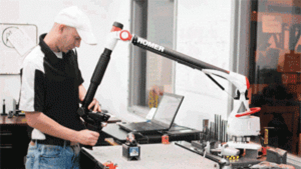

Charles Gibbons, a foundry layout technician, scans the part and overlays the point cloud with the CAD model to locate are any deviations from the original design.

The foundry wanted to learn more about laser scanning for CMM. Output generated from laser scanning creates a three-dimensional model, or “point cloud,” of an object’s surface. The dense coverage of data (potentially millions of individual points) creates the point cloud, and those results are compared against nominal CAD values. During CADto- part comparison, large point clouds are overlaid on the CAD model for fast visual inspection of deviations. The result is sometimes described as a “color map.” Surfaces that are especially complex with lots of curvature and difficultto- access features benefit the most from laser scanning.
A little more than a year ago, Rochester Metal invested in a Romer Absolute Arm with a factorycalibrated, integrated laser scanner, expecting to improve the data-collection and inspection process. Instead of manually collecting the individual points, the scanner is passed over the part almost as though the operator were “painting” it, as described by a supplier source. Making scans at different angles ensures that all the relevant geometry is captured. After scanning, the foundry’s Layout department will overlay the point cloud with the CAD model to see if the part has diverged from the original design intent. Also, because all the inspection data must be traceable back to the NIST standards, the length standard and calibration sphere included with the Romer portable CMM guarantee the laser’s accuracy.
The process time saved after adopting non-contact scanning was an immediate benefit to the foundry. Formerly, if an operator needed to collect data points manually, he had to figure out how to fixture the part. Now, he simply sets the casting on a table and begins scanning. There are no concerns about the part moving, which would have required him to start over, and the whole process proceeds more quickly. This speed is particularly apparent when Rochester Metal Products produces sample molds for a new pattern. Once the Layout department verifies all measurements are correct according to the CAD reference, the Engineering department is notified that the tool build has been successful and the PPAP proceeds. This process may have taken up to a week by manual inspection; with the laser scanning capability it takes approximately one or two days.
