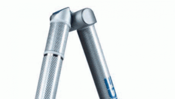

The Faro Edge is a portable measurement arm that allows Palmer Foundry to verify product quality by performing inspections and tool certifications, and may be used for reverse engineering and other data-driven tasks.

Palmer Foundry has adopted an integrated quality control and inspection system that uses laser scanning to collect millions of reference points on casting dimensions and surface conditions, compiling an extensive documentation — for first article inspection (FAI), for quality control, for tooling or mold maintenance, and more.
“It’s a valuable tool in troubleshooting, because it gives us a baseline of data for a part,” Palmer Foundry president Bob Logan said.
“Typically, in the past, we’d inspect a part and it might lead to a multipage blueprint with 150 or 200 dimensions that we had inspected on a casting,” the foundry’s vice president, Dennis Hayden, elaborated. He noted that the integrated package of coordinate measurement arm and laser scanner, working with 3D inspection and metrology software, create a virtual model of the ideal part.
“Now, with this laser scanning capability, we’re measuring as many as 2 million data points, if we choose,” Hayden continued. “It gives us a truer representation of the space that the part is occupying. There is a tremendous amount of data that we are capturing that we could never capture before.”
The CMM device is a Faro Technologies Faro Edge system, with on-board measuring capabilities that make it portable package, with “smart connectivity” and “smart sensor” technology, among numerous other capabilities that simplify the task of measuring objects and collecting data.
“The set-up task for each part is improved, too,” Logan offered. “Before, we’d have to position the part and balance it, and with this package we just set the part on the table and go. And, in the past if we had to do multiple setups to inspect a larger part we’d have to move it and repeat all the preliminary steps. The time savings adds up.”
Working with the CMM is an integrated, high-speed 3D scanner that uses laser technology to produce detailed, three-dimensional images of complex geometries, quickly and efficiently.
Speed is a significant aspect of the system’s effectiveness. “When we used more conventional technology to perform physical inspections, 200 dimensional measurements on a single casting might take two people two or three days to complete, depending on how many setups were needed,” Hayden pointed out. “So, with a laser scan we can collect 2 to 4 million points in maybe four hours. We get a lot more data in a shorter period of time.”
Software, of course, is part of the integrated system; for the Palmer Foundry installation, it is Geomagic’s Qualify digital metrology program It calculates the geometric dimensioning and tolerancing (GD&T) measurements for the data points that the arm and laser scanner collect, and compares those results to the solid (FAI) or CAD standard. This information is converted to a 3D graphic that highlights any variations from the standard, with data, detailed graphs, and narrative descriptions for any differences.
