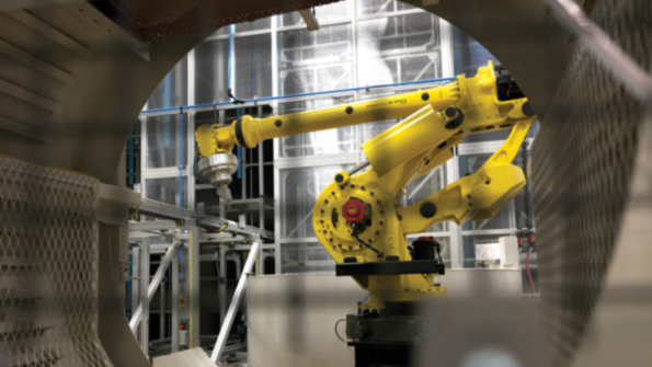

At Tampa, those molds are injected with wax to create patterns, which are assembled and dipped into ceramic slurry to create the ceramic shells. In addition to more than doubling its shell capacity from 60 to 150 per day, Chromalloy boasts that the new plant’s shell line “redefines state-of-the-art process control.” Trotter maintained that much of that process is proprietary information, but he allowed that it has been developed “to eliminate some of the problems that historically have plagued shell lines.”
The purpose is to control temperature and humidity throughout the shell line process to prevent problems like over-drying or under-drying. “We get a very consistent drying level,” he explained, “and we utilize four different drying zones to be able to dry at different rates through different steps of the process, and really to customize the drying process to the configuration of the part.”
These steps are tied together with a control system that allows Chromalloy to monitor different aspects of the shell process in real-time, and adjust accordingly, for maximum control and productivity. “So, for example, if I’m running a large IGT part,” Trotter detailed, “and the next mold happens to be a small, aerospace part, within the same shell line I can tailor the process so that I optimize it for those two parts, without having to reconfigure the system.”
