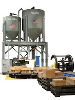

RFID technology has a very clear application in no-bake molding. The communications system consists of two components:
1. RFID Tags (small electronic devices that are attached to a core or mold box). Each tag has a unique identifier and memory to store additional data such as recipe numbers.
2. RFID Readers (devices that wirelessly communicate with the RFID tags) identify the box that the tag is attached to, and then associates the tagged box with related data such as mixer run time required to face and fill, type of sand or blend used, resin percentage, resin ratio, catalyst percentage, dry additive percentage, compaction table vibration intensity and duration required.
Both the tag and the radio are two-way radios. The reader interfaces with a PLC to transfer the data obtained from the tag to allow the PLC to set the mixer and conveyor/carousel parameters.
The recipe number and settings are entered into the RFID tag via a touch-screen on the mixer control panel or another PLC. The RFID tag, which mounts on the box, is programmed with a specific recipe number. When it is in range of the reader antenna, the parameters of the recipe number (resin %, ratio, etc.) are entered into the system PLC. The tag can be re-programmed any time and the ability to change a recipe number can be password protected. Additional recipe numbers with the associated control parameters can be entered into the PLC at any time.

After programming, the RFID tag is added to the mold box to identify itself to the mixer. Programming can be performed either at the production line or by downloading the settings from the company Ethernet.
At the start of the molding process, the cleaned box is ready to be filled with all necessary loose pieces, reinforcing rods, insulating sleeves, filters, etc. As the box flows past the RFID reader, the system reads the information on the tag and sends the information to the operating system. This read function can be automatic or the operator can perform it with a hand held reader. Depending on the style of the tag, it can hold different amounts of data, but generally it is simpler and the tag is less expensive to store only the pattern or job number on the tag.
Once the box is in the correct position, the operator starts the cycle. At this point the operator is no longer needed for any decisions as to the different settings of mixer run time, resin level, powder additions, etc. He needs only to move the sand to the correct part of the box as it is discharged to be sure the pattern is covered with the correct recipe. No operators is needed if the mixer is equipped with an automatic fill pattern mechanism on the mixer discharge, with an auto strike-off station (after the fill station.) Both of these functions are easy to integrate into the recipe number.
