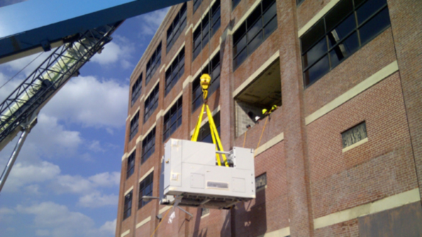

The ExOne SMax printer will be one of the largest operating 3D printers in North America according to University of Northern Iowa Metal Casting Center director Jerry Thiel He noted that the riggers installing the machine had four inches to spare as they brought it through a third story window at the research center in Waterloo IA last month
