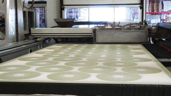

The build space for the turbine wheel cores in VX4000 3D printer

Once the necessary CAD data for the wheel was available, Voxeljet started the process of producing the flow-carrying interior for the Francis wheel. In this step, forming the monoblock sand core is a fully automated process using 3D printing. It replaces several sequential, manual processes for producing core segments. In contrast to standard mold manufacturing, for which producing model plates or core boxes may can take several weeks, 3D printing makes it possible to print smaller sand molds in as little as a few hours.
Building the Mold
The 250-mm mold for the Francis wheel was built in layers over a period of almost five hours. Precision is a factor: the process has an accuracy of 0.2 millimeters in thexand Y directions, which is setting new performance standards. In principle, Voxeljet's large-format printers can produce molds of particle material in dimensions of 4x2x1 meters.
The molds are created without cumbersome and expensive mold set-ups, and the production process is fully automated. It is based solely on CAD data, using the layer building method, which consists of repeated application of 300-micrometer thick quartz sand layers that are selectively glued together with a binder using the print head of the system.
This method offers significant production-related advantages that affect quality, production targets, and profitability equally. In this case, 3D printing resulted in higher component accuracy, a significant reduction in subsequent machining, and excellent surface quality and contour precision.
After the printing process is complete, the mold has only to be unpacked and cleaned of excess sand, and it is finished. The molds are easy to handle, so they can be transported to the foundry easily. Due to their low binder content (1.2%) and a pressure of 220N/cm², the sand cores are comparable to those produced in conventional series production. They can be used immediately for further processing and are ready for casting.
