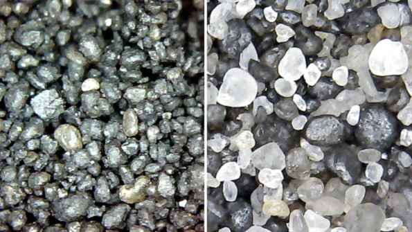

Molding sand as seen before left and after right treatment in the Renofont reactor

The process equipment is relatively simple, centered on a “Renofont reactor,” the vessel in which the sand cleaning activity is carried out. The reactor operates with water only, and consumes very little energy.  All of the supporting tools and process equipment is generic, including screens, tanks, pumps and plumbing, conveyors, and a decantation system.  Every installation is engineered according to the needs and space available for specific foundry customers.
The Renofont reactor.
Once installed the Renofont process becomes another stage in a foundry operation. Pre-screened, used sand is measured and conveyed to the Renofont reactor. A precise quantity of water is measured and injected into the reactor, and the system starts: used sands are dropped into the reactor. Once the reactor is activated, bentonite and sea coal are separated from the sand, and the automated system ejects bentonite and sea coal as a “slurry.” This material is available for returning to the make-up area for molding and core sand.
A particular advantage of using this “slurry” is that the bentonite component is already swelled, so that green sand will reach its full strength faster.
Next, more water is added to the sand remaining in the reactor. The system is reactivated for a final cleaning of the sand, as impurities (include ‘dead clay’) are evacuated with the water to a decanting station. There, the water is recycled to the system.
The remaining clean sand is ready to be screened to match the foundry’s AFS goal, and while a minimal volume of sand is rejected, clean sand is ready to return to the casting cycle. Water from this final screening is recycled, too.
The system is scalable to different foundries’ sand volumes, and for larger foundries adding a second reactor to the operation can increase the system volume. For even larger needs, more than one production line can be coordinated
Boucher noted that there is no chemical reaction in the process, which uses water exclusively as a cleaning agent. He noted the principle involves cleaning the sand so that active bentonite and sea coal are extracted into the slurry, which can be reused as the clay and carbon component of a new molding sand mixture.
